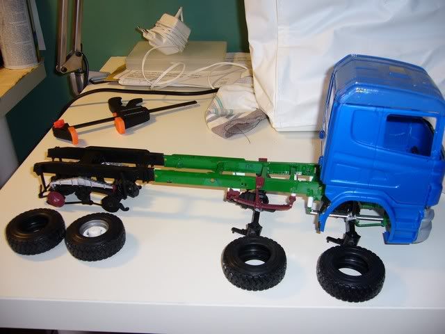

RE: Scania R480 8X8 Army Edition

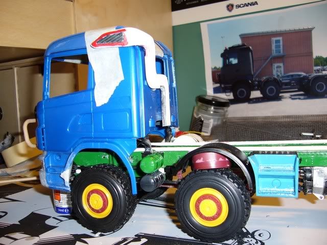

Hi Hakan, where are the wheels from?
Jan

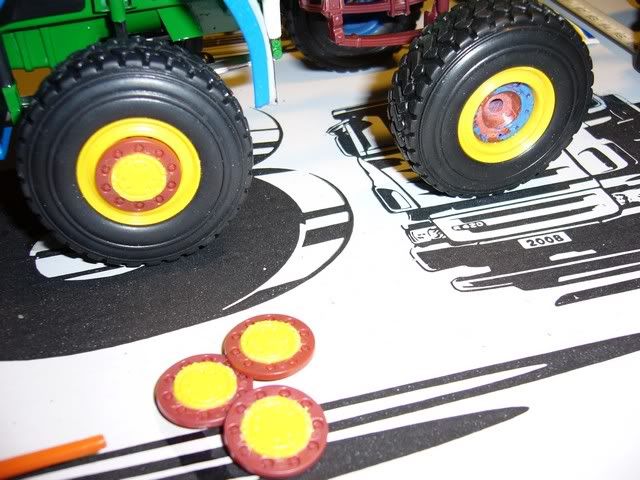

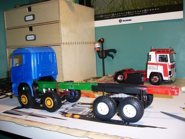

Samstag, 10. Januar 2009, 23:13
Hello,
The wheels are from a JCB wheel loader toy I found at the local toy store. The tyres are in rubber and they actually fir right on the Italeri rims :ok: :smilie:
Best regards
Håkan

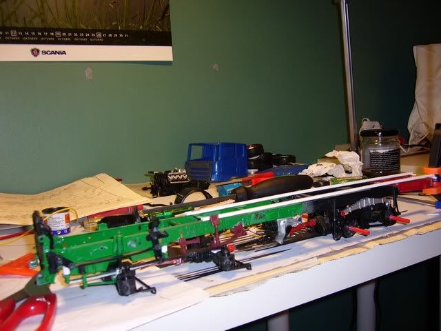

Montag, 12. Januar 2009, 21:15

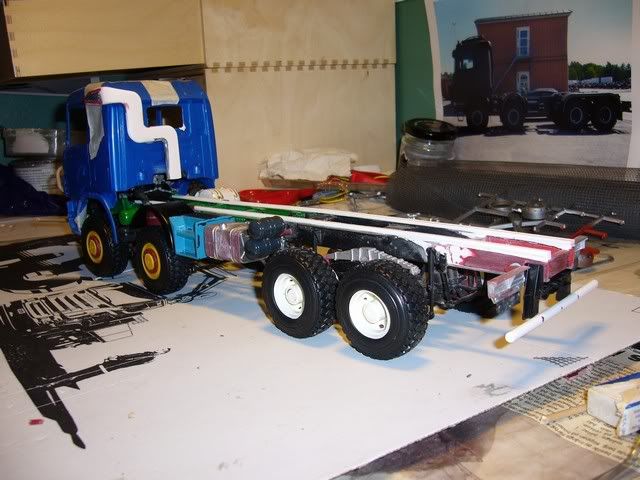

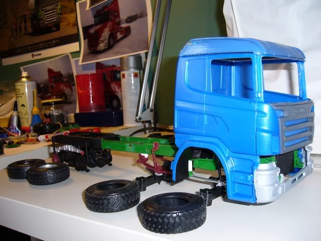

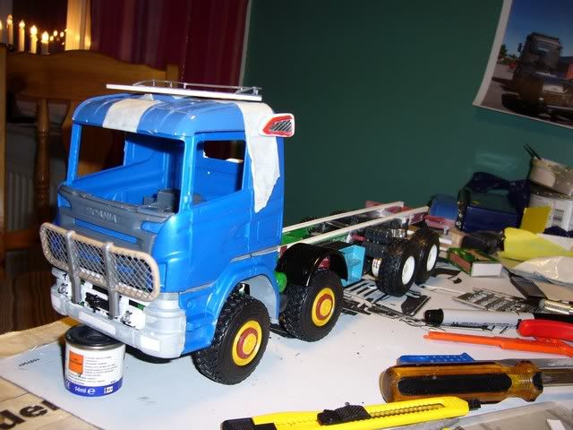

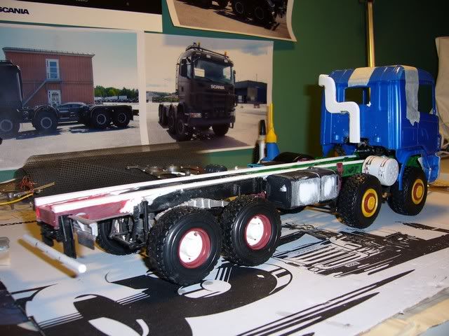

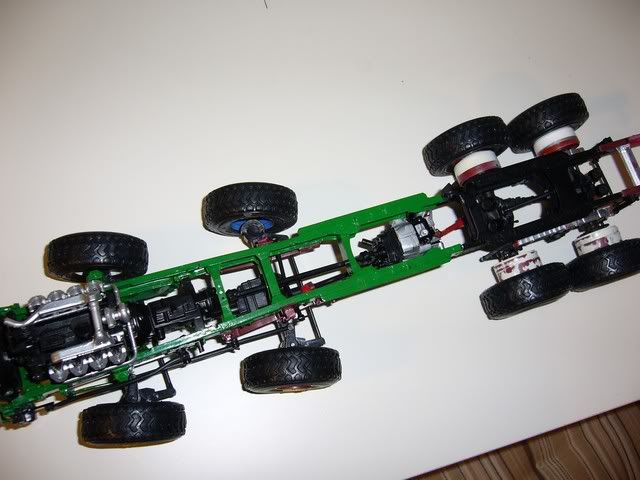

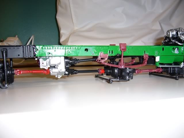

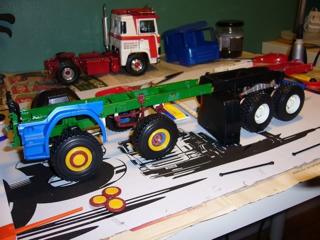

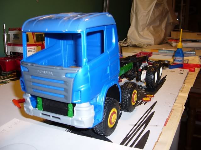

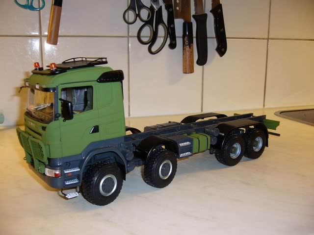

Hello again!
Thanks for the comments!

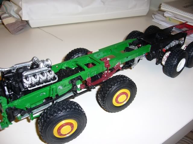

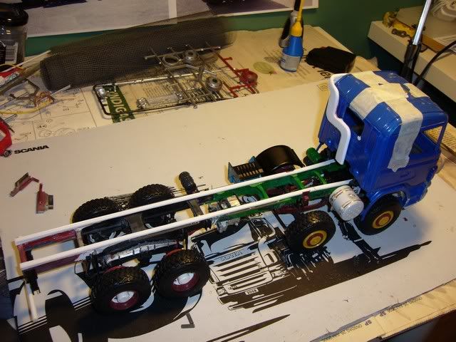

There has been some work done on the wheels and rims lately and the chassis.
To be continued…..
Best regards
Håkan

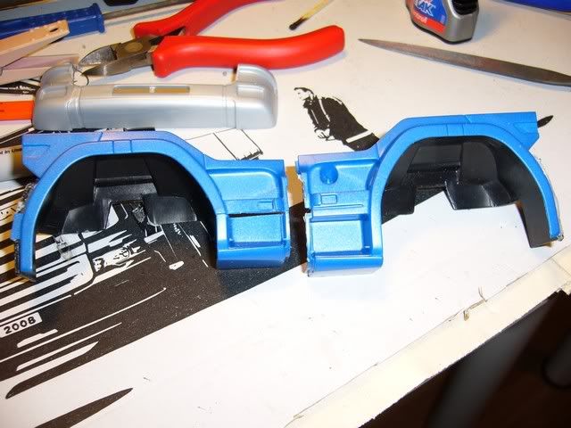

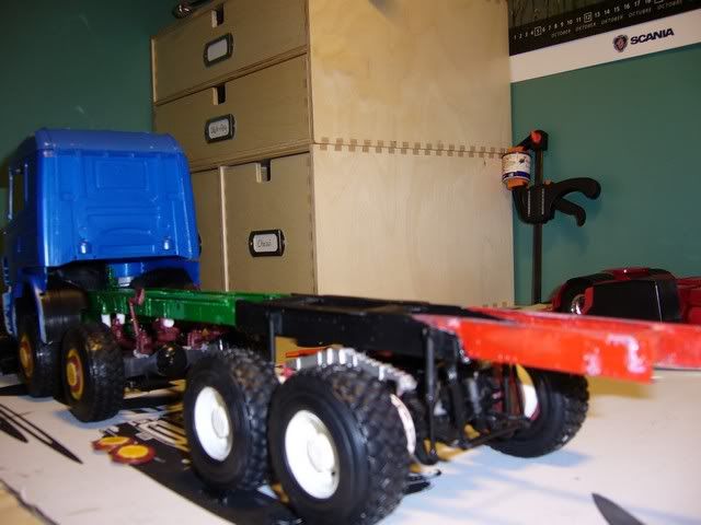

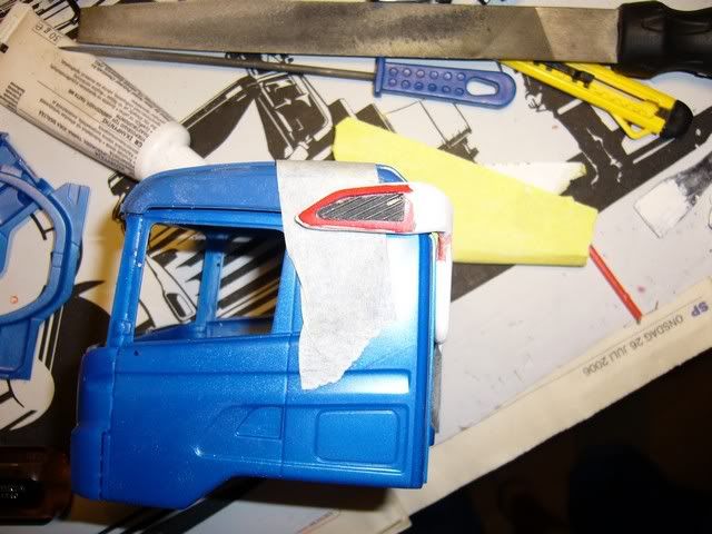

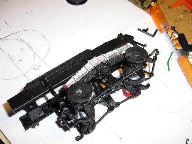

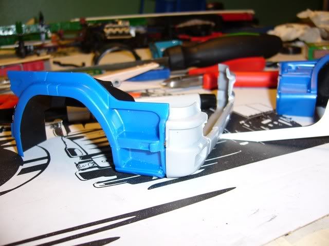

Samstag, 17. Januar 2009, 15:49

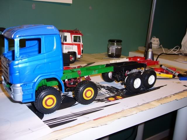

Hello again!
It is time for a new update of the Scania R480 8X8 Army project.

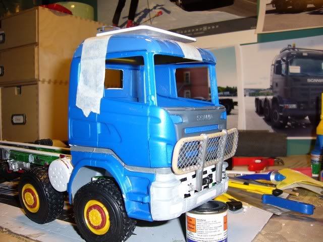

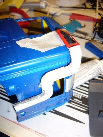

I needed to cut the foot steps in order to make the shorter since I am going to use the Scania 4-series front.
To be continued…..
Best regards
Håkan
Samstag, 17. Januar 2009, 16:16

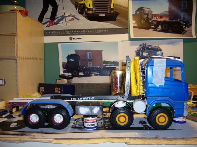

Hi Hakan
looks great the update :). Where you have the distributor gear? Is it selfmade ?
Greetings :wink:
Ralph
Sonntag, 18. Januar 2009, 23:08
Hello!
The transfer gearbox is self made but I actually used some parts from a gearbox of a Tamiya BMW K100 motorcycle kit in scale 1/12 ! That in combination with some other “junk yard” parts I had turned out to work just fine for this project.
Best regards
Håkan

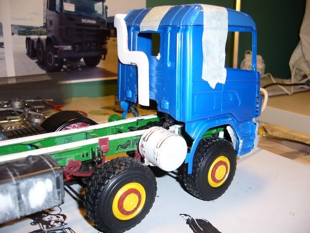

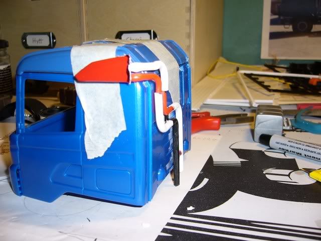

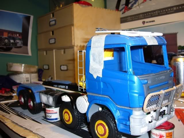

Montag, 19. Januar 2009, 22:36
Hello!
Thanks for the comments! :smilie:

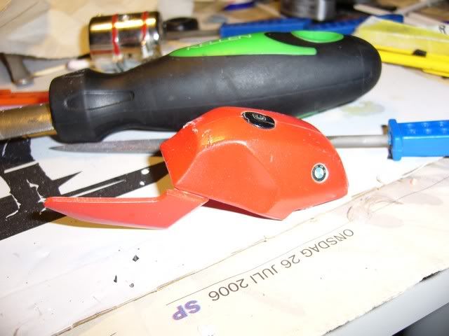

There has been a small progress in the Scania R480 8X8 Army project. I have spent some time working on the high air intake. Even here I used a piece of the fuel tank from the BMW motorcycle kit. I try to use as much old “junk yard” parts as possible.
A small progress on the chassis has happened as well but still it remains much work…..
To be continued……
Best regards
Håkan

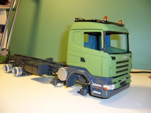

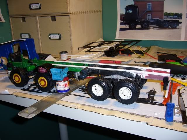

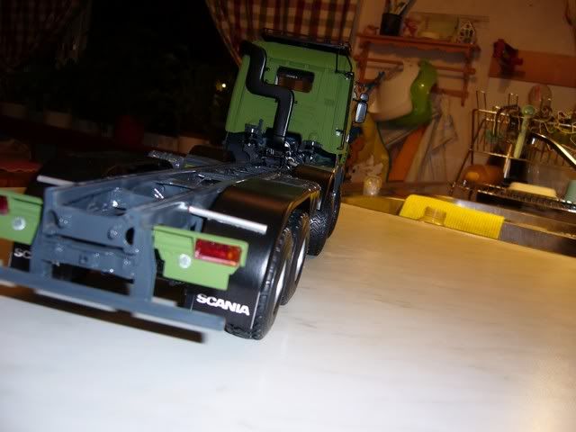

Donnerstag, 22. Januar 2009, 18:37
Hello!

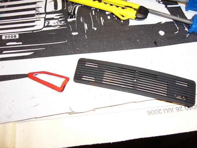

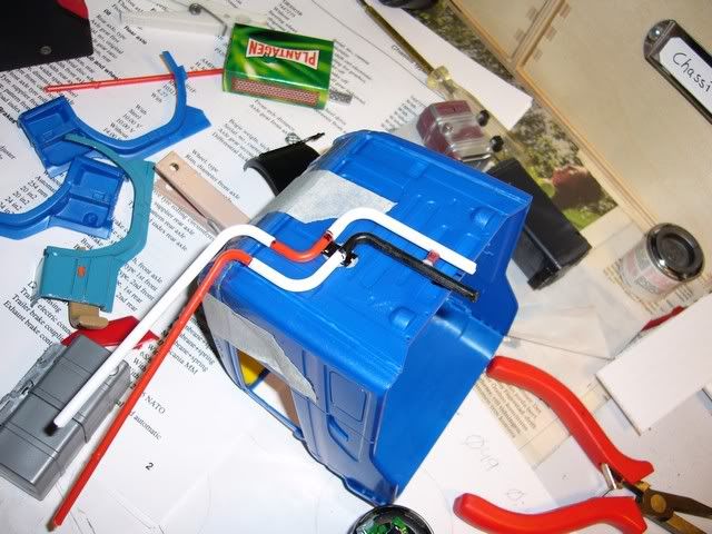

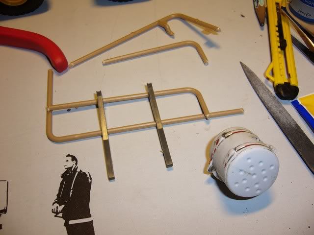

It is time for a new update. I have made a silencer and a wildbar.
I also made a test assembly:
To be continued……
Best regards
Håkan

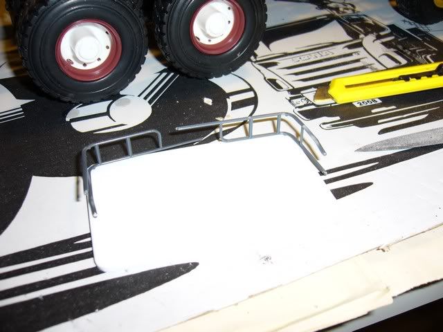

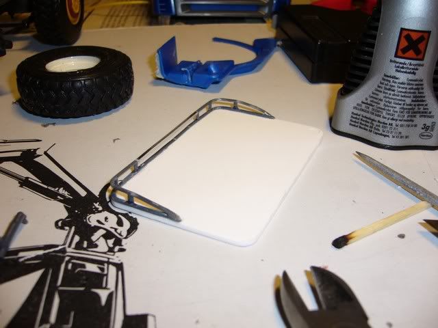

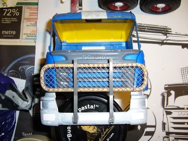

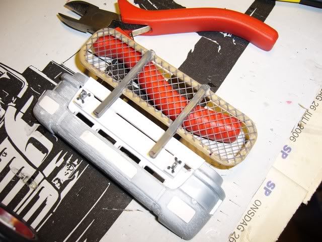

Sonntag, 25. Januar 2009, 22:44
Hello again!

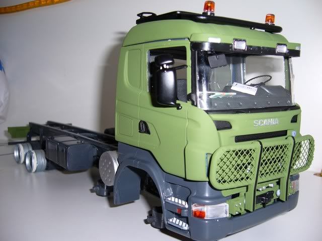

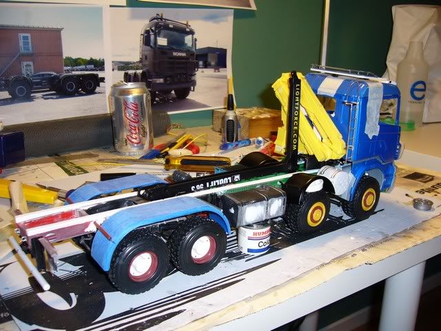

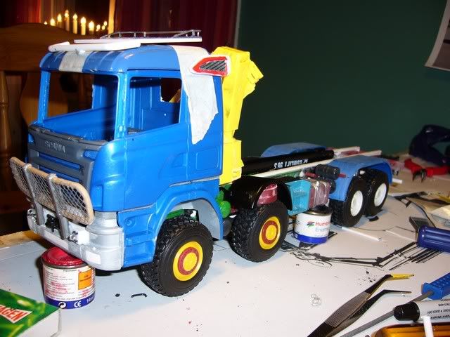

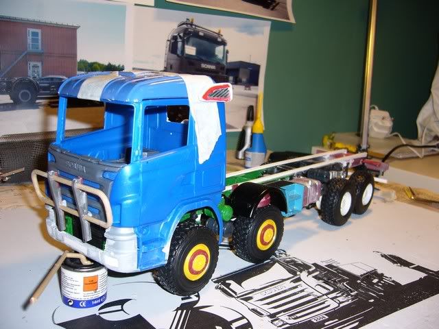

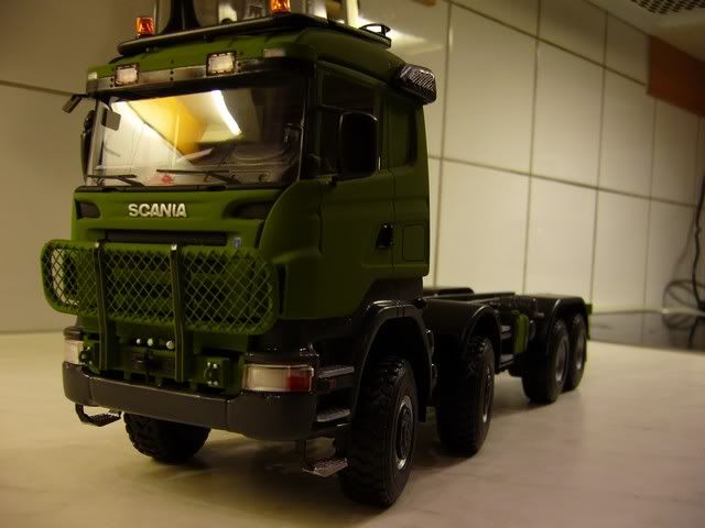

There has been some further progress in the Scania 8X8 Army project. A roof rack, the lower part of the front grille and the wildbar has been finished. Now there only remains a few more details until it is time for the paint job.

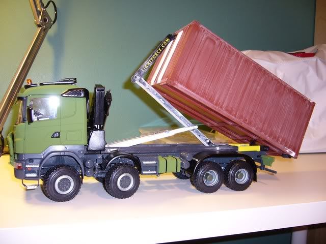

I have also plans to scratch build a hook lift and then I am going to have a 20ft container as load.
To be continued…..
Best regards
Håkan
Donnerstag, 5. Februar 2009, 20:22
Hello again!
Ok it is time for the last update before the paint job.
To be continued…..
Best regards
Håkan

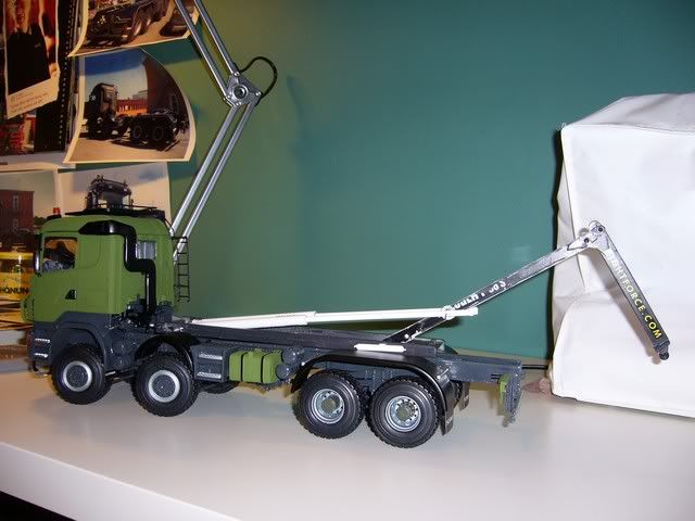

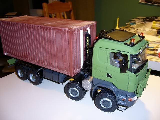

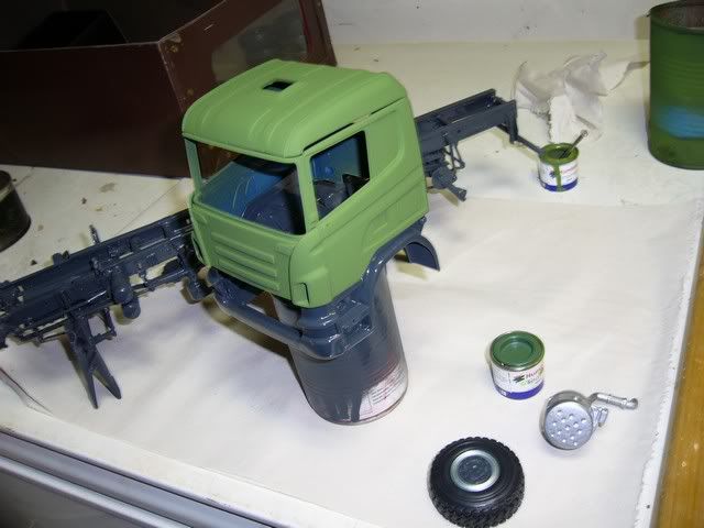

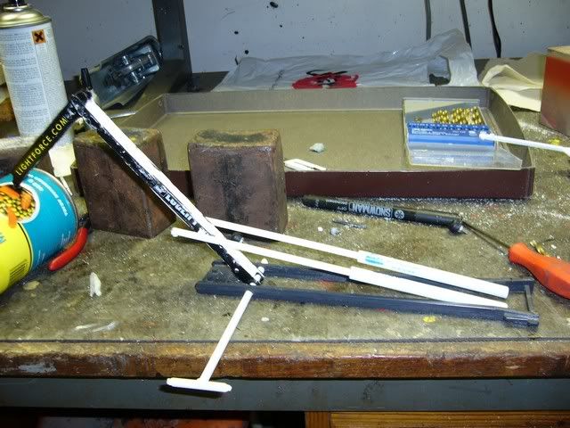

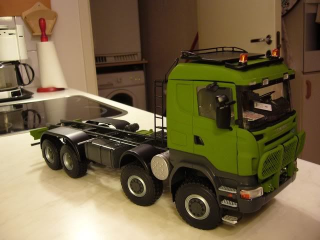

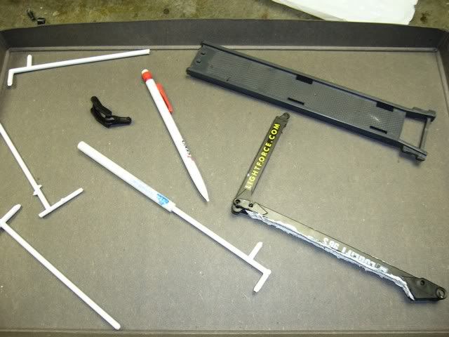

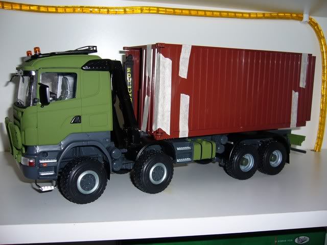

Samstag, 7. Februar 2009, 17:35
It looks interesting so far...

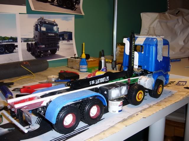

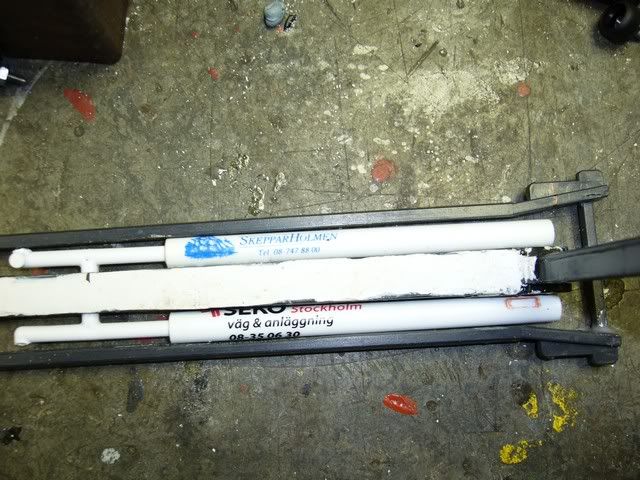

Sonntag, 8. Februar 2009, 13:23

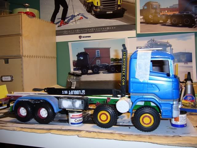

Hello again!
Now the paint job is done.
I have also been working on the hook lift. I used some old pens as hydraulic cylinders.
Best regards
Håkan

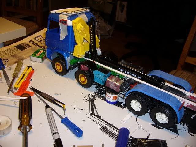

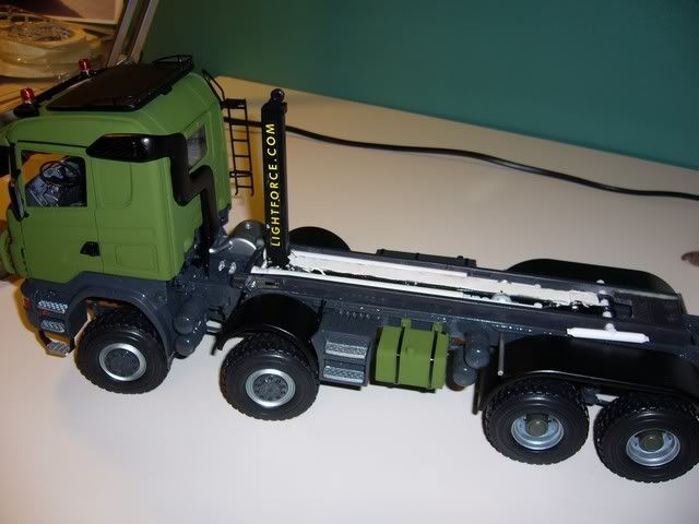

Mittwoch, 11. Februar 2009, 20:17
Hello!

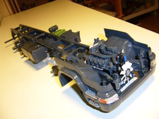

Now there has been some further progress of the building process of the Scania R480 8X8 project.
To be continued......
Best regards
Håkan

Freitag, 13. Februar 2009, 18:02
Hello!
Thank you very much for the positive comments and feedback!

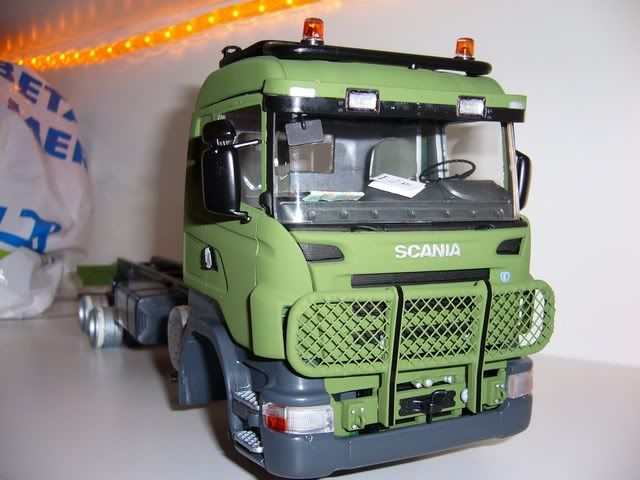

To answer your questions Nige: No the Dutch Army order of Scania 8X8 vehicles did not include any crane behind the cab. It has a hook lift for containers or other type of loads as body build. But the Irish Army for example has a few of those Scania 8X8 vehicles as well and some of them do have a crane fitted behind the cab in combination with a hook lift. To be completely honest I am not making a detailed copy of any existing vehicle but my model is strongly influenced by several Scania Army orders such as the Dutch, Irish and so on.
Regarding the cab it can be upgraded with a ballistic kit which means a lot of extra armour to both the front and the side of the cab. This also includes thick bullet proof windows and so on.

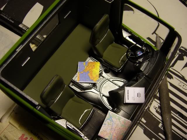

Now back to the model project. Lately some interior work has been done. As details to the interior I added a couple of maps and also a drivers manual for this type of Scania 8X8 Army vehicle.
To be continued…..
Best regards
Håkan

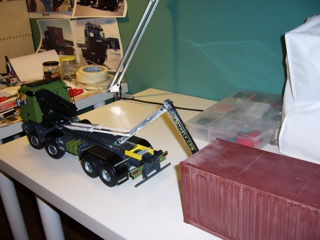

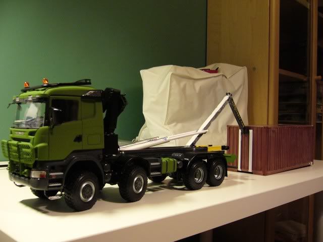

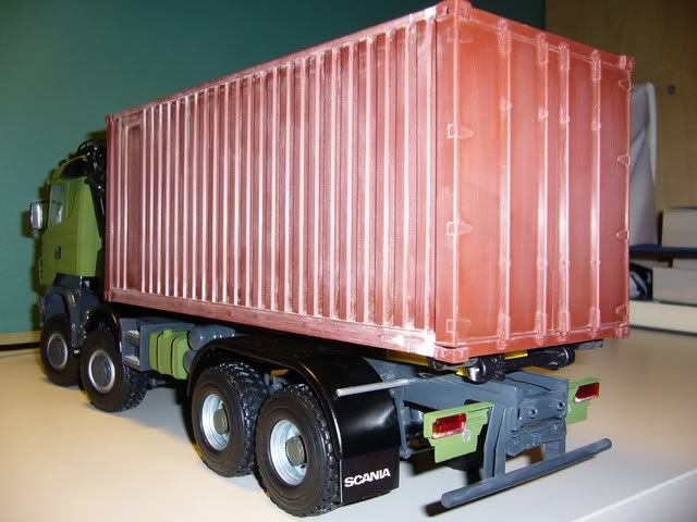

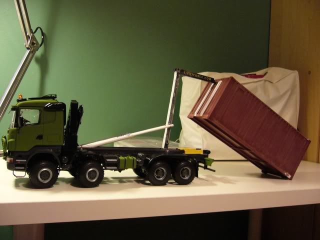

Mittwoch, 18. Februar 2009, 11:31
Hello!

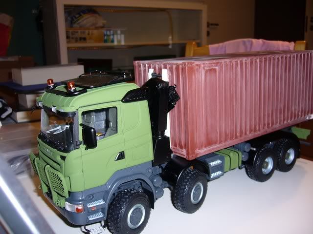

Now it is getting closer to a finish of this project. There are still some work to be done on the hook lift and the 20ft container.
Best regards
Håkan
Sonntag, 22. Februar 2009, 20:58
Hello again!
Now it is soon time for the paint job of the hook lift and the 20ft container. It seems to fit and work as it should by now.
Best regards
Håkan
