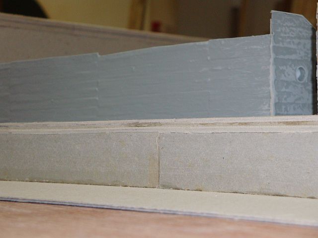

A close up, showing the presence of the wooden concrete shuttering and the round penetration at the side for the fresh air inlet.

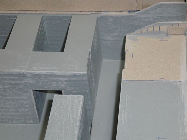

The layout of the gaslock chambers.

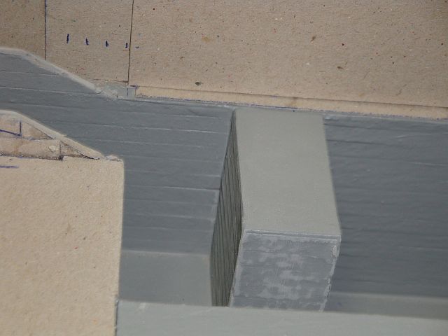

A view of the gaslock at the other side. Again notice the rough finish of the concrete structure.
The plan view of the internal of the ammunition bunker, which was divided into four sections. three of which were used to house the rounds and the cordite cases, while the third section used to house the fuses for the 17cm shells and ammunition for the anti-aircraft defence guns and other weaponary. Note the 6 x square inserts in the rear wall. These were purposly made to house the air exhaust valves for the ventilation system. I also created a view window in order to be able to see the inside of the bunker, when the roof slab is in place.
