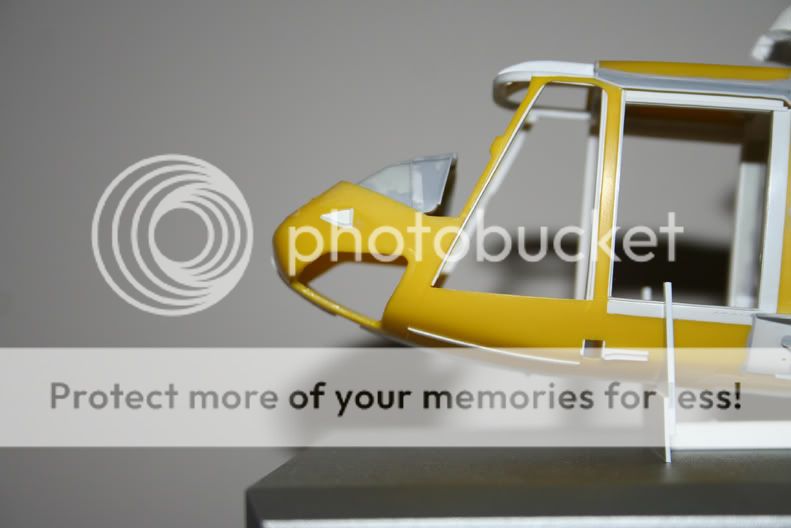

I am trying to decide when I rescribe her wether to use my "Rosie the Riveter" or try these Archer rivet decals, any thoughts. I have never seen the decals before, are they any good?
Quickly snapped a couple of pics of the upper windscreen framework finished, quite happy with it as it turned out to be quite a tricky job.

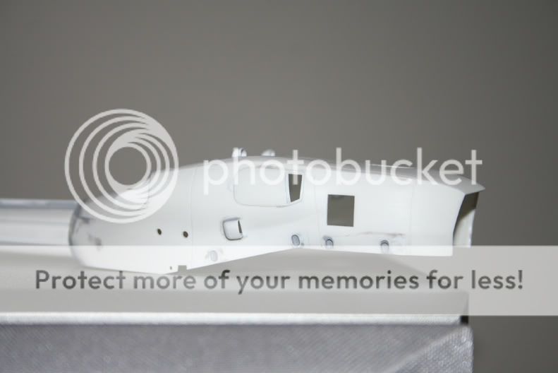

Well I had a good amount of time working on the BK this past few days and got a lot done.....for me anyway.
I hope my photo sizes are ok as I am not very good at this sort of thing
First up was the upper door track .
My kits moulded on fairing had quite an uneven line where it met the fuse. First up I scribed a line 4.5mm up from the lower edge of the fairing and scribed the panel line with an upward kink near the front(5.5mm back from the upper eyebrow window). Then another line 1mm lower was scribed. This second line runs across the top edge of the fairing and will serve to evenup/sharpen the point where the fairing meets the fuse. Then I flodded this line with Mr Surfacer and began the ardious task of blending it all together to accurately represent how the track should look. This took me ages and was a little more tricky thanI thought to get looking right.
Next up was the heavy gauge alloy plates rivetted to the side where the winch brackets attach. These are percular the the NZ machines and had been measured up prior to being made. I used 10 thou card and then it was sanded/buffed down to a more appropiate thickness that looked "right" and Mr Surfacer brushed around the edges to slightly blend it all together and buffed back
Then the clips for the mounting of the oxygen bottle was next up. My measurements were scaled back and this area was made. This part is to be sprayed red when the airframe gets painted also.
Then the part that slightly daunted me was all the many many drains/vent tubes dotted all over the lower fuselage. I measured up all their positions and used my Waldron punch and die set and using the 1,2 & 3 sizes I punched all the appropiate diameters and MEK'd them to the fuse in their respective locations. They still need their centres drilled out and various diameter hypodermic tubing inserted.
Finally I started rescribing the fuse(you probably cant see that with my crappy photography), I now have all the major panels scribed ready for the hatches etc to be next.
As you can see, the rear strakes behind each of the skid openings have been made along with the little circular plates on the front surfaces.
I dont think I have missed anything, so I will let the photo's speak for themselves.

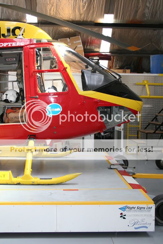

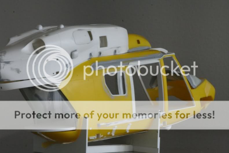

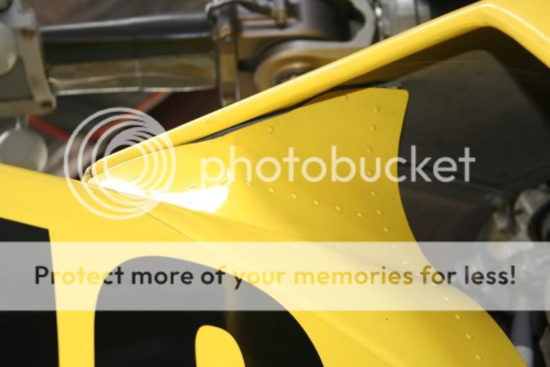

Well, as I mentioned earlier I went down to take a few shots/measurements off the BK and noticed that the upper door track was more complex than it looks in photo's.
My scribed lines on the top of the track just didnt look right, so I scraped a horizontal track for a strip of .010 x .020" plastic card to neatly sit in it., then I basically went right around the track with a curved end piece. After that I placed a strip along the lower face of the rear track (there is a ridge running along there) after that another piece of .010 x .020" strip was glued along the bottom edge of the front half with a final angled piece up by the door.
Hopefully this pic illustrates it better than I can explain.
This now gave me positive lines to blend in with filler to portray the subtle curves. The wider strip on the rear front face had the top bevelled in and Mr Surfacer 1200 was then brushed around it all to smooth it off. This actually took several applications until I was satisfied it was perfectly even and looked just like the real thing.
Next up is the gutter running along the lower edge. This really had me puzzled as I really didnt know how to accurately portray this. Finally after much gazing at photos I found some .020 / 0.50 round rod (Plastruct). I taped a length on my cutting mat and passed over it a few times to put a small flat on one side. This was then bent to shape and glued as I went. These pics should illustrate how I did that part.
Once this was carefully glued on (flat side to fuse) I rubbed it back with fine emery paper and contoured it to the right profile. I also thinned the card edges of the track to give an accurate scale thickness to the panel.
And this is one side finished. I am just working at finishing the stbd side at the moment.
This really took me a LOT longer than I thought it would, but I am really happy at how it looks now and am glad I did it.

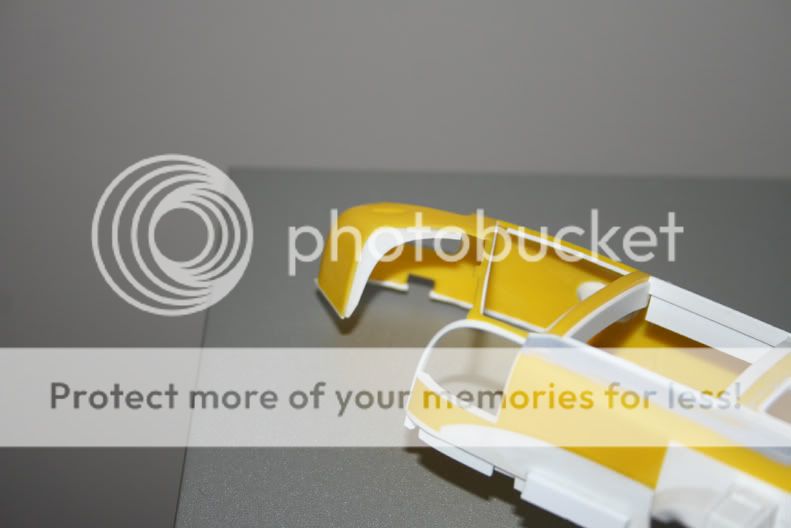

I have been busy making another sliding door to match the other side as well as tidying up many small details around the fuselage.
Well, I have just spent the last hour or so making the upper sliding door track at the forward end. I wasnt sure how to go about it, but when you break it down it isnt too bad after mindlessley staring at photos for ages.
There is a fine channel the door runs along, the channel I had was too chunky even though it was quite small, so I used an "L" section and scraped/sanded it back even smaller with thinned edges, then got a piece of 10thou card and glued it on the back, effectively giving it an h section. This works well as there is a panel in behind the channel (ha), this will all be sprayed satin black eventually.
This is the first one....looks ok to me and am happy how it turned out.

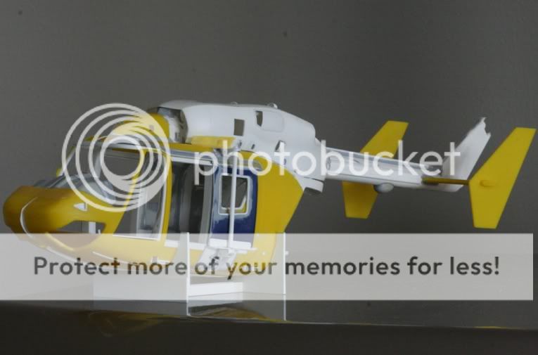

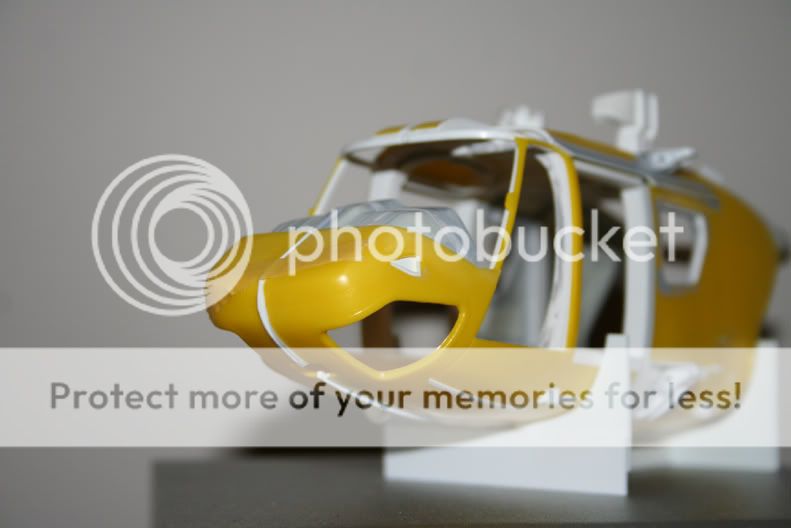

Wish I could show more work for the time spent this past week or so.
Anyway, I came across a problem of the instrument panel covers front contours not matching the windscreen line. No matter how I moved it around I just could not get it to fit properly! Time for a trip to see the machine herself and see where I went wrong or what I was missing.
As soon as I saw it I realised 2 things:
1. There was a recess through the centreline of the cover that the centre windscreen frame passed through
2. There was a panel between the windscreen and the cover(just below the frame line......phew!
This entailed me fitting a 10 thou piece of card around the top edge as I have cut the lower windscreen line down to the frame line to compensate for the new windscreen fittment and replacement frame.
Now the front edge of the panel cover is too big and needed cutting right back and a constant trimming was needed for a nice fit. This took a fair bit of time as I had to make sure it was at the right height.
I wasnt going to glue this in but after many nights of fitting & trimming I decided that I really needed to if I was going to have a nice fit. It is going to slightly complicate things for me down the track, but I dont think I had any choice for the best result.
I jigged everything up and glued it in finally!
Then Mr Surfacer was brushed around the edge, I am really happy with how it turned out.
you can see in this photo the centre ridge has also been added.
I had to remove the temporary windscreen centre frame as this was only added earlier to line things up.
Here are a few quick pics before I go to bed
What do you think.....did I get it right?????? I hope so, I have spent so long on it I cant tell anymore! There may be a little tweaking here and there, but on the whole I think it is pretty close.
Excuse the photos...its getting late......again

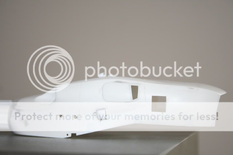

Well this week I decided I needed a change of pace so decided to do the intake scoops on the engine cowl.
So I tried my hand at vac-forming...........it took a little practice, but here is what I did
This shape gave me 2 ends (2 scoops) and I measured up the positions on the cowl and cut the openings. I then trimmed the vac part up and poked it up through the hole.
I need to tidy up around the edge where it pokes through the opening, but otherwise I think it will be ok. I just have the ones on the side to do next.

Well, I have been quietly beavering away on the BK cowl. This time I have been working on the oval depressions that the latches go onto. I realised that the EC cowl latches are quite different to the BK
First up, I measured the positions and then drilled a hole in the centre of each position. Then a tiny circular file was used to elongate each hole, making sure that it had straight sides not rounded.
Once the 'hole was drilled and shaped, I then thinned the inside out to a correct thickness. Once this was done, I blanked off the inside with plastic card and once again "flooded" the area with Mr Surfacer and buffed back to give a pressed alloy look. I had to be careful as some of them are deeper than others.
Anyway here is the result.
Getting pretty close to priming this piece.......just have to scribe a few panel lines etc first.

Mittwoch, 28. Oktober 2009, 09:30
Well, a quick photo update as I had to take some quick snaps for the "Air Rescue" magazine.
I have actually been busy......but still trial fitting/ sanding/ and shimming it all so I wont need much filler on final assy.
I spent a lot of time on the fairing in front of the engine cowl again. There are tricky compound curves on the inside roof that need matching, like this
It took a lot of building up to get it right. I just realised I didnt take a pic of that area I finished. You may be able to see it in this one.
She is really starting to take shape now. I am making a template to hold the brass exhaust pipes etc. I have been also working on the end plates (vertical stabs), but I have a lot yet to do on those.
I think next up has to be the etch.................................I cant put it off any longer, I really dont want to mess it up.
